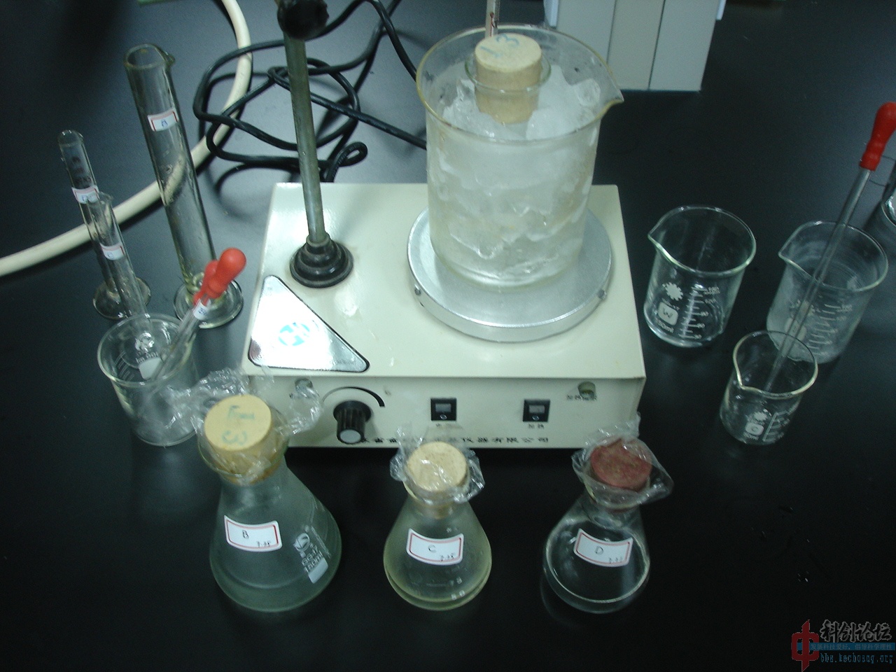

我最近这几天在看关于芳基重氮盐反应的Paper,对这方面产生了浓厚的兴趣,决定亲自动手试试。实验方案是我根据各Paper作者的叙述设计出来的,并在实践中不断改进和完善。
这是我第四次做这个实验。我深知重氮化反应是一个技巧性很强的工作,半点疏忽都会使产率大打折扣。对于我这个愚钝的人来说,是一个很大的挑战。 Schiemann01.jpg

Solutions
B PhNH3Cl 2.115 mol/L
PhNH3Cl 16.4338g, H2O 40mL, HCl(conc. aq) 20mL
C NaNO2 4.890mol/L
NaNO2 10.1222g, H2O 30mL
D NaBF4 4.793mol/L
NaBF4 15.6696g, H2O 30mL
Consumption
B 30mL, 0.06345mol PhNH3Cl
C 14.3mL, 0.06980mol NaNO2
D 13.2mL, 0.06345mol NaBF4
Procedure
1. Diazotization

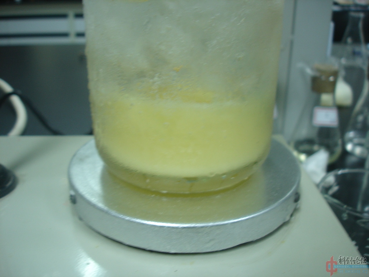

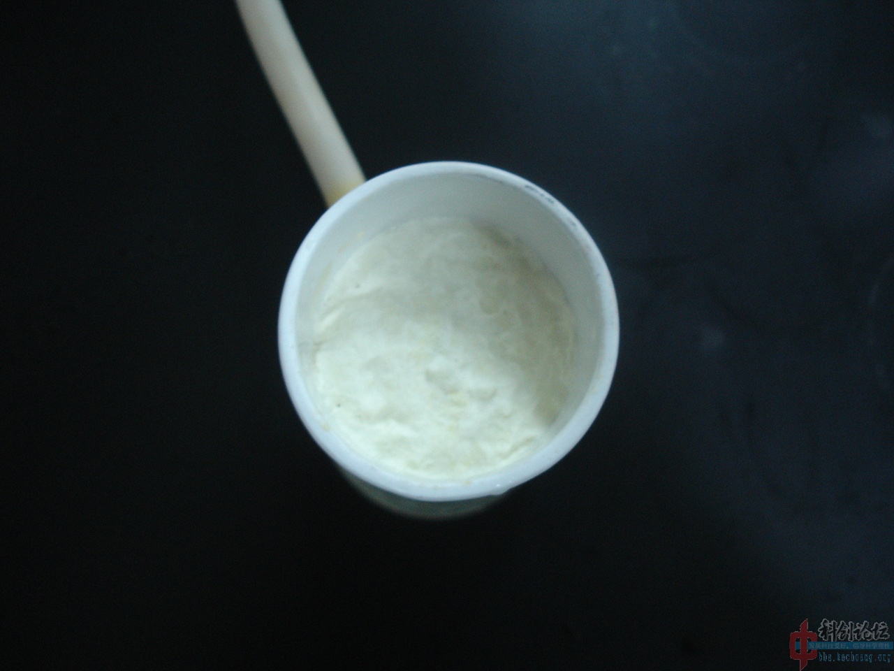

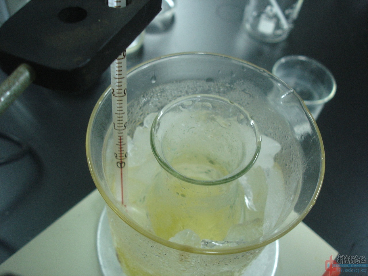

A conical flask contains 30mL B, is equiped with a magnetic stirrer and an ice bath, adjust the bath temperature below 5°. Then add 14.3mL C dropwisely within 15 minutes, drop ice pieces every 5 minutes in order to keep the temperature below 10°. After the adding complete, stir the solution for 7 minutes, and pour in 13.2mL D at once. A layer of light yellow laminar crystals(diazonium fluoroborate) appear. Then stir for another 15 minutes. Filter the precipitates by suction, and leach it with 20mL ethanol and 20mL of aether in turn. 3.5912g of light yellow solid is obtaind, with the yield of 29.6%.

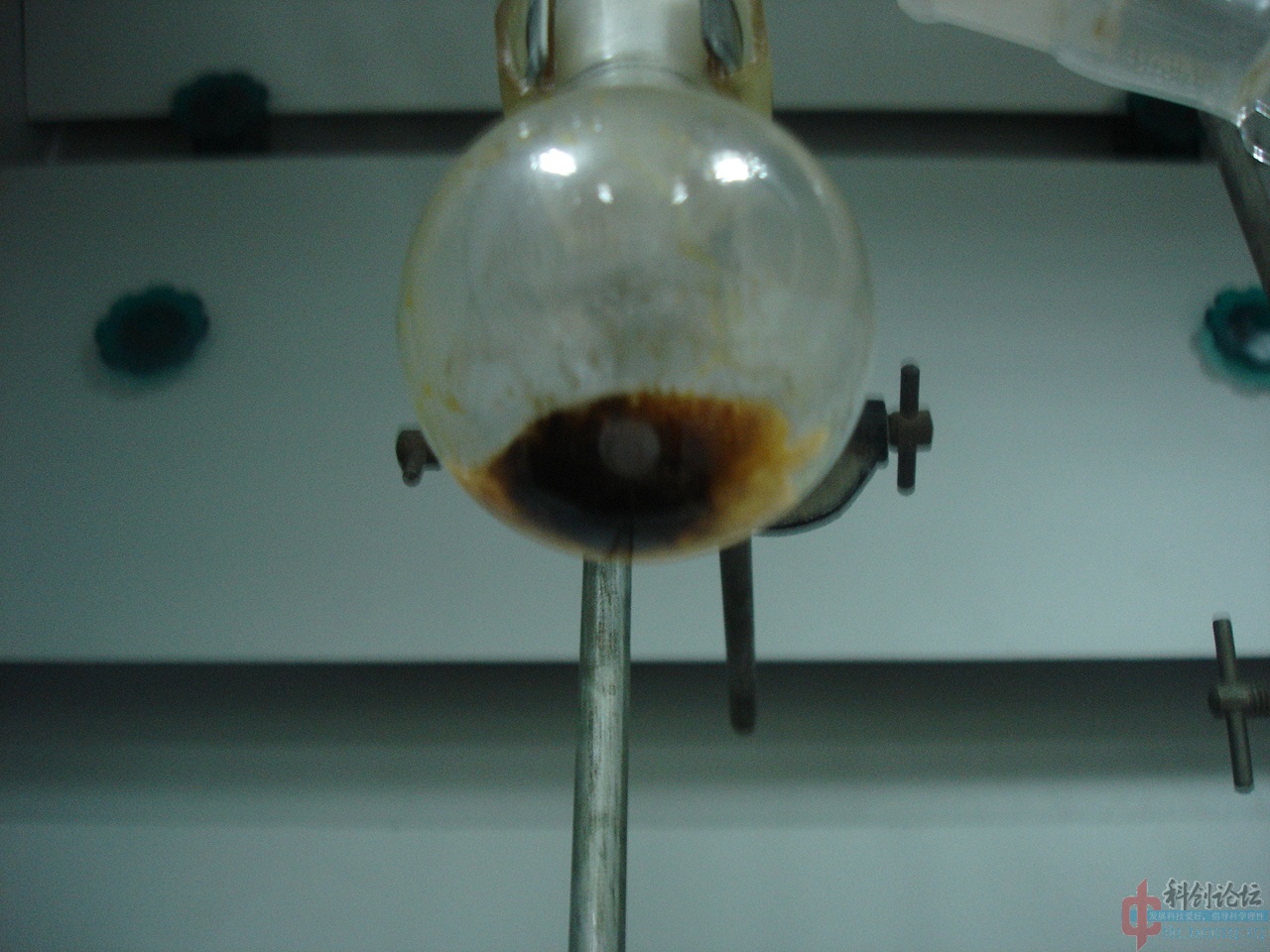

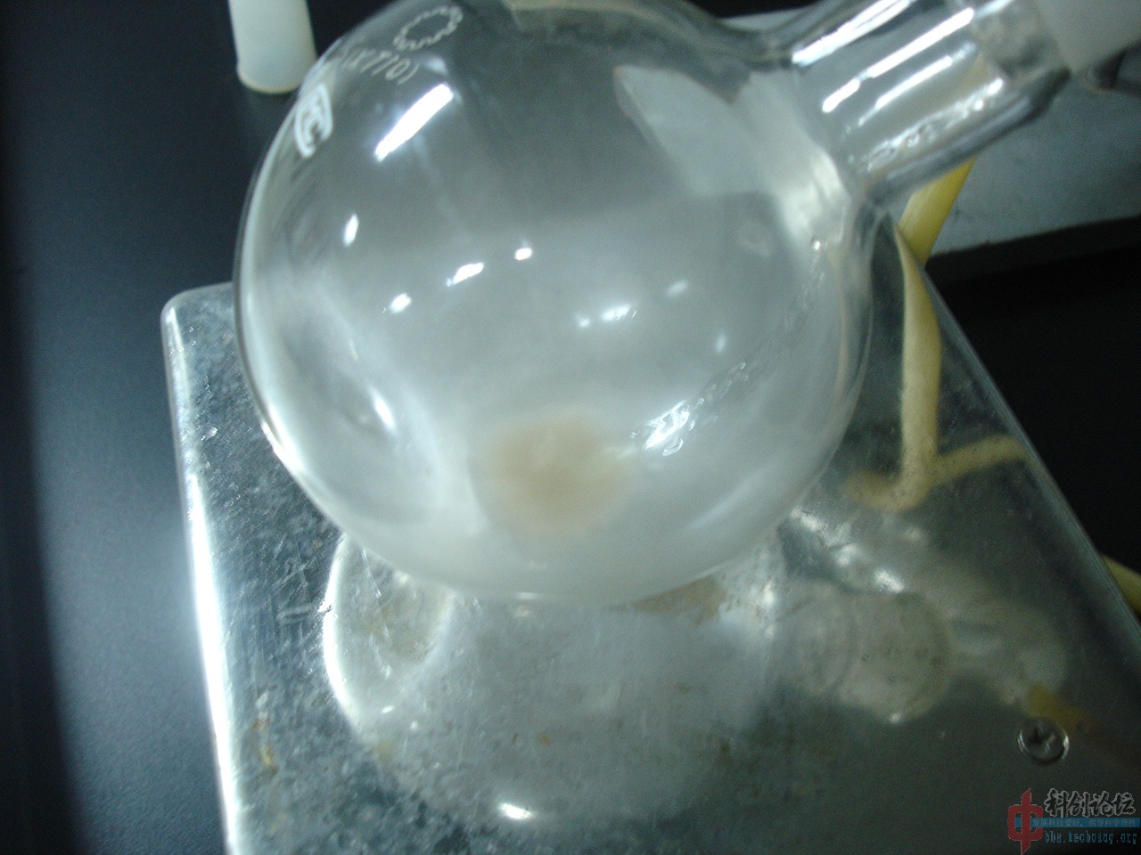

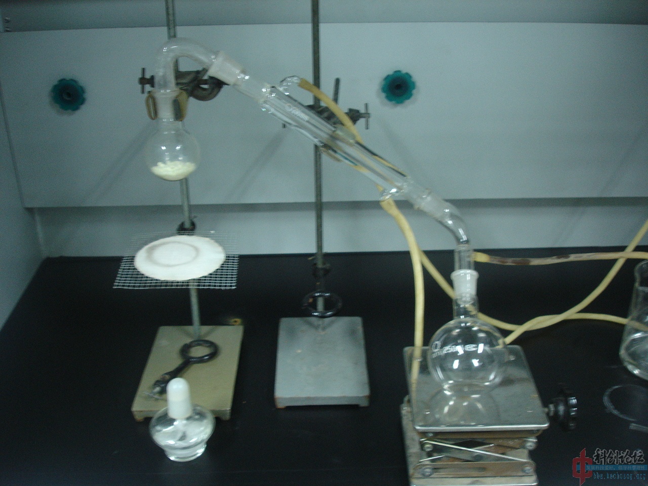

Contain the solid obtained in the last step with a 150mL round bottom flask, which is equiped with a condenser and receving apparatus. Heat on one point near the edge of the solid layer with an small flame (eg. alcohol burner). Withdraw the flame as soon as the reaction is initiated. The reaction proceeds spontaneously and smoothly while the solid is melting, bubbling and white smog generating. After the disappearance of the solid, heat the flask and distill the dark-red liquid residue. 1.1mL of colourless, benzene-smelled liquid(fluorobenzene) is obtained, with the yield of 62.8%. The total yield over two steps is 18.6%.

Stiring with water for long, the newly generated diazonium salt may suffer from nucleophilic attacks in aqueous solution. This may result in the low yield in the 1st step.
