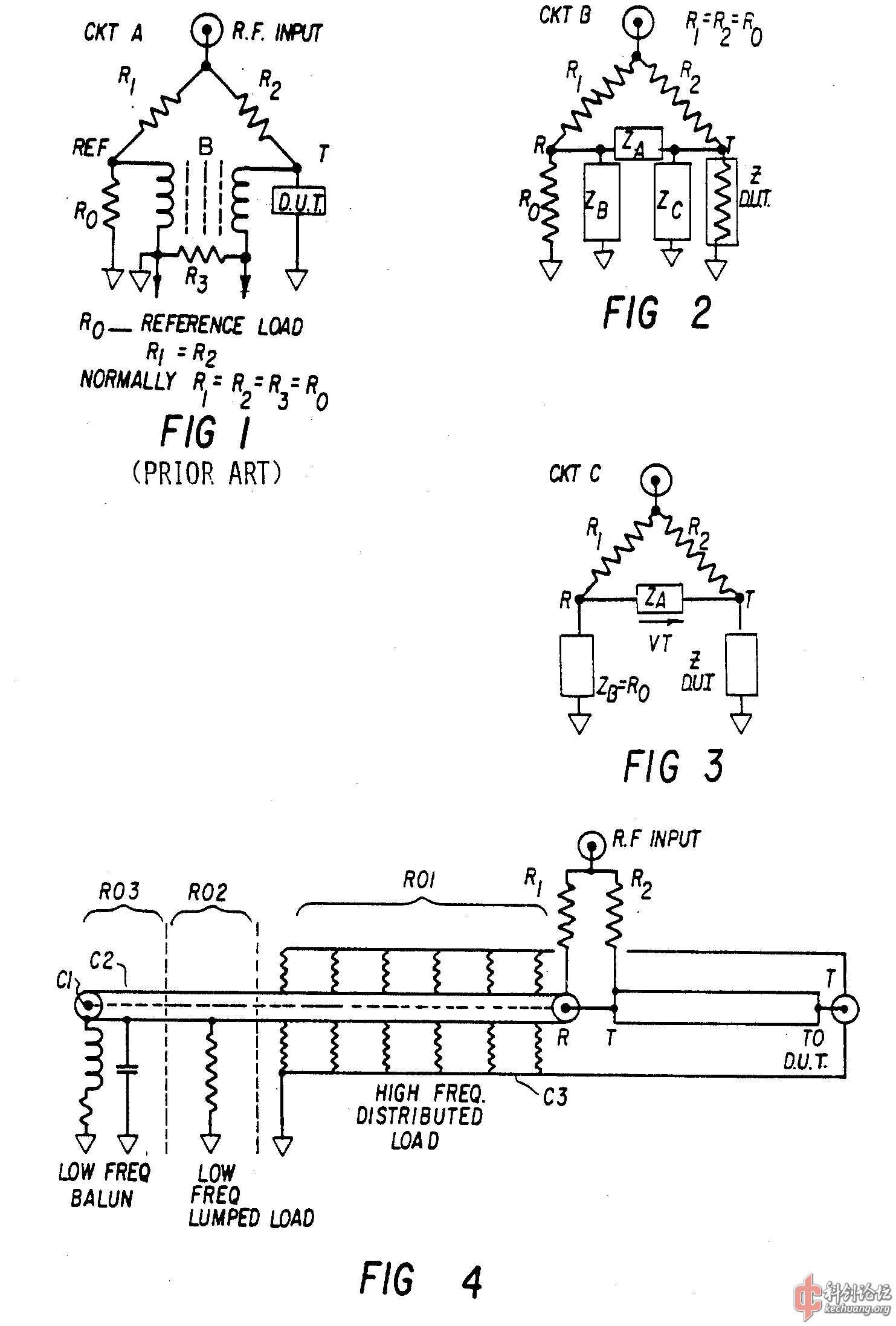

In accordance with preferred embodiments of the invention, shown in FIG. 3 is a design for an R.F. terminated Wheatstone bridge which does not require either high shunt impedance or delicate balancing. Here all the elements and relationships are the same as those in FIG. 2, except that the shunt impedance ZC is substantially eliminated and ZB is made to be R0, where R0 is a constant impedance (typically 50 ohms) over the frequencies of interest, thus eliminating the separate resistor for that function and achieving a balanced bridge. With this structure, it can be shown by simple circuit analysis that the floating voltage VT, generated across the terminating impedance ZA, is proportional to the reflection coefficient of the D.U.T.

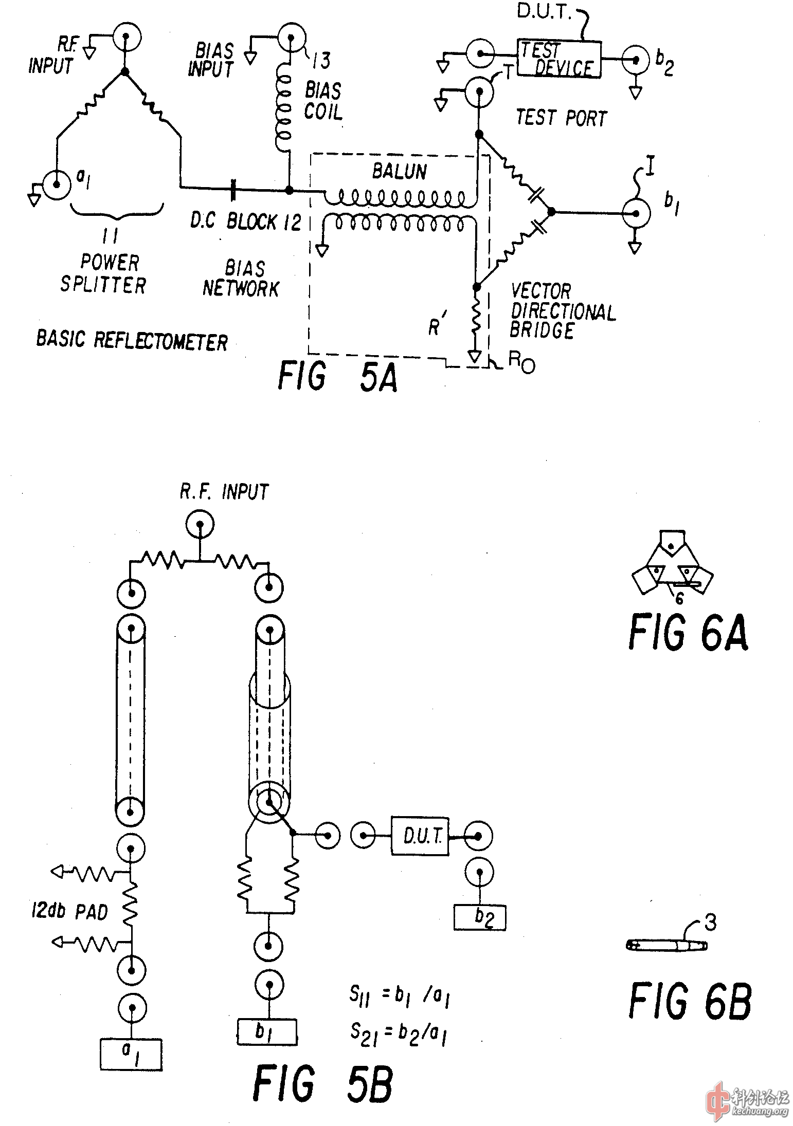

While the built-in detector of a scalar bridge can easily convert the floating R.F. voltage VT to a single-ended D.C. output, the vector bridge of FIG. 3 is faced with a much more severe challenge. It must extract the floating R.F. signal and feed it to a single ended vector detection system, without upsetting the delicate symmetry and impedance level of the bridge. For this reason, it should be readily apparent that R0 must be a precision element with a flat response over the entire frequency range of interest, which in the preferred embodiment is generally from 45 MHz to 26.5 GHz. In order to provide such a constant impedance over this large bandwidth, R0 is typically a composite system as depicted in FIG. 4. As illustrated, R0 has three distinct elements. The first, R01, is a high frequency distributed load for preventing signals at the reference port from seeing any shunt impedance other than R0. Unlike an isolated lumped resistor which provides virtually no isolation, such a distributed load can be made to provide almost any degree of isolation commensurate with acceptable dimensions. Such isolation requires, however, that there be sufficient loss per unit length to avoid introducing shunt impedance at the frequencies of interest. Losses of 20-25 dB along the length of the load (40-50 dB isolation) are generally sufficient to avoid bridge imbalance.
The second stage of the reference impedance, R02, is a lumped load placed at the end of R01 to provide a termination at lower frequencies where losses in the distributed load, R01, are insufficient to achieve isolation. To avoid parasitic shunt impedances at these lower frequencies, the third stage, R03, a ferrite core (balun), is added to keep the shunt reactance high. The magnitude of the impedances of R02 and R03 are chosen so that their combined parallel impedance is equal to R0 since R01 is transparent at low frequencies.
Another important feature of this structure is its triaxial nature, i.e., having a center conductor C1 inside a coaxial conducting sheath C2, which is itself inside a second coaxial conductor C3. Because the input and detector ports of a vector bridge are functionally interchangeable, either port may be driven while the other extracts the reflected signal. Hence, by reversing the orientation from that shown in FIG. 4 and driving from the balun end R03, the test port T can be D.C. biased by means of center conductor C1 (e.g., to provide power to transistors and I.C.'s in the D.U.T.). Such a reflectometer design is illustrated schematically in FIG. 5A. Here the balun and R' together represent the reference impedance R0. The system is fed through an R.F. power splitter 11 to provide a reference signal and to supply power to the bridge. b1 corresponds to the signal at port I together and b2 corresponds to the signal after transmission through the D.U.T.
The vector ratio b1/a1 is proportional to the input reflection coefficient while b2/a1 is proportional to the transmission coefficient of the D.U.T.. Also, included is a D.C. block 12 for isolating the R.F. power input from the bias voltage provided by bias input 13 on the center conductor of the reference impedance R0. Shown in FIG. 5B is a typical reflection/transmission test setup which is particularly adapted for use by an automated R.F. network analyzer.

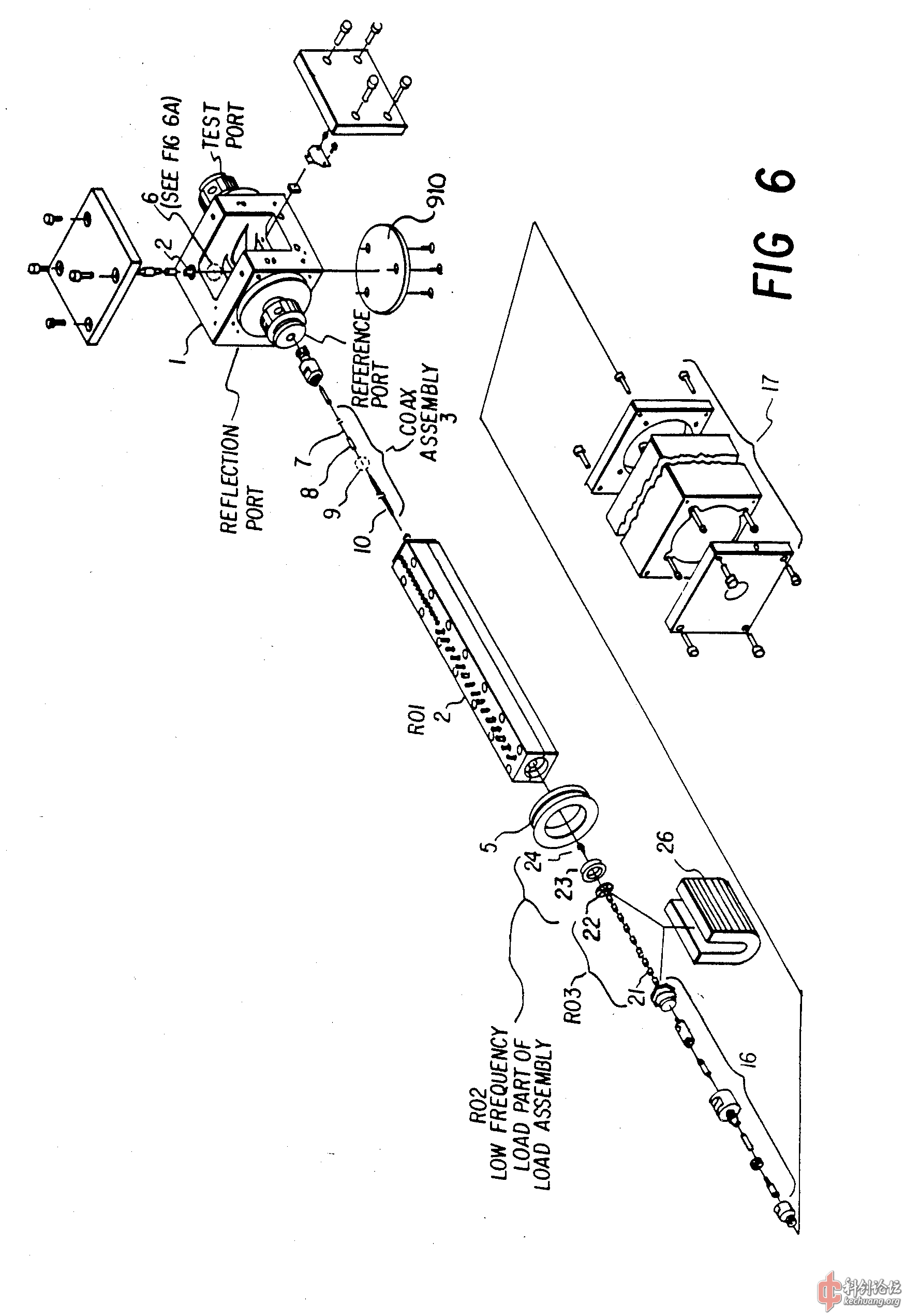

In accordance with the preferred embodiments of the invention, a practical implementation of the bridge and the accompanying precision broadband load assembly is depicted in a somewhat exploded view in FIG. 6. The system is made up of a bridge assembly housing 1, which contains a bridge microcircuit 6 (shown in enlarged view in FIG. 6A) for providing electrical connections between the reflection port, the test port and the reference port. Also included in housing 1 is an adjustable spring loaded top ground plane 2. Also shown is a coax assembly 3 (also illustrated in an enlarged view in FIG. 6B) for connecting the high frequency portion R01 of the reference load to the reference port of the microwave bridge. This is accomplished by providing a tapered transition from center coax 10 of R01 to center coax 7 of the reference port which feeds microcircuit 6, the transition being accomplished by means of an inner taper 9 and an outer taper 8 as shown in FIG. 7A. At the other end of the distributed portion of the R01 reference load is the lumped load R02 which is made up of a 61.5 ohm resistor 22 and an inner conductor 24 and outer conductor 23. Attached to lumped load R02 is the balun section R03 made up of a series of ferrite beads, such as bead 21, located on the coax. The impedance of R03 is generally chosen to be about 285 ohms in order to provide a combined shunt impedance with R02 of 50 ohms.
Balun R03 is typically formed into a single loop for mechanical stress relief purposes and a pad of polyurethane foam 26 is formed around it for protection from impact. Coax assembly 16 then provides connection for R.F. input and D.C. bias, and a grommet 5 is used to stabilize the positions of loads R02 and R03 in a load shroud assembly 17.

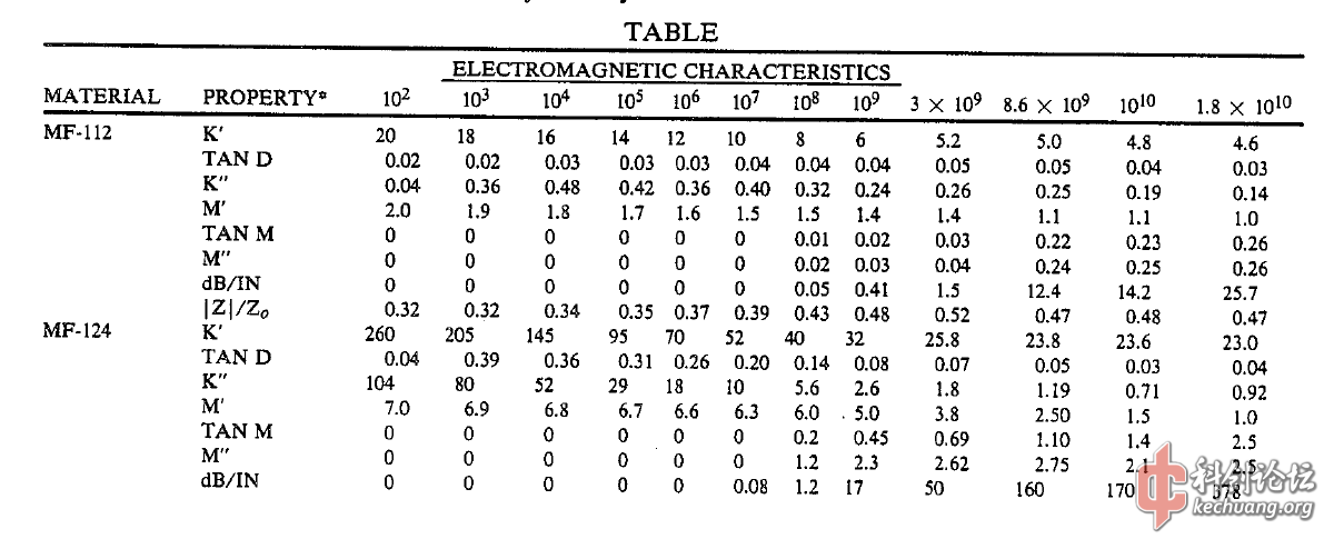

表1

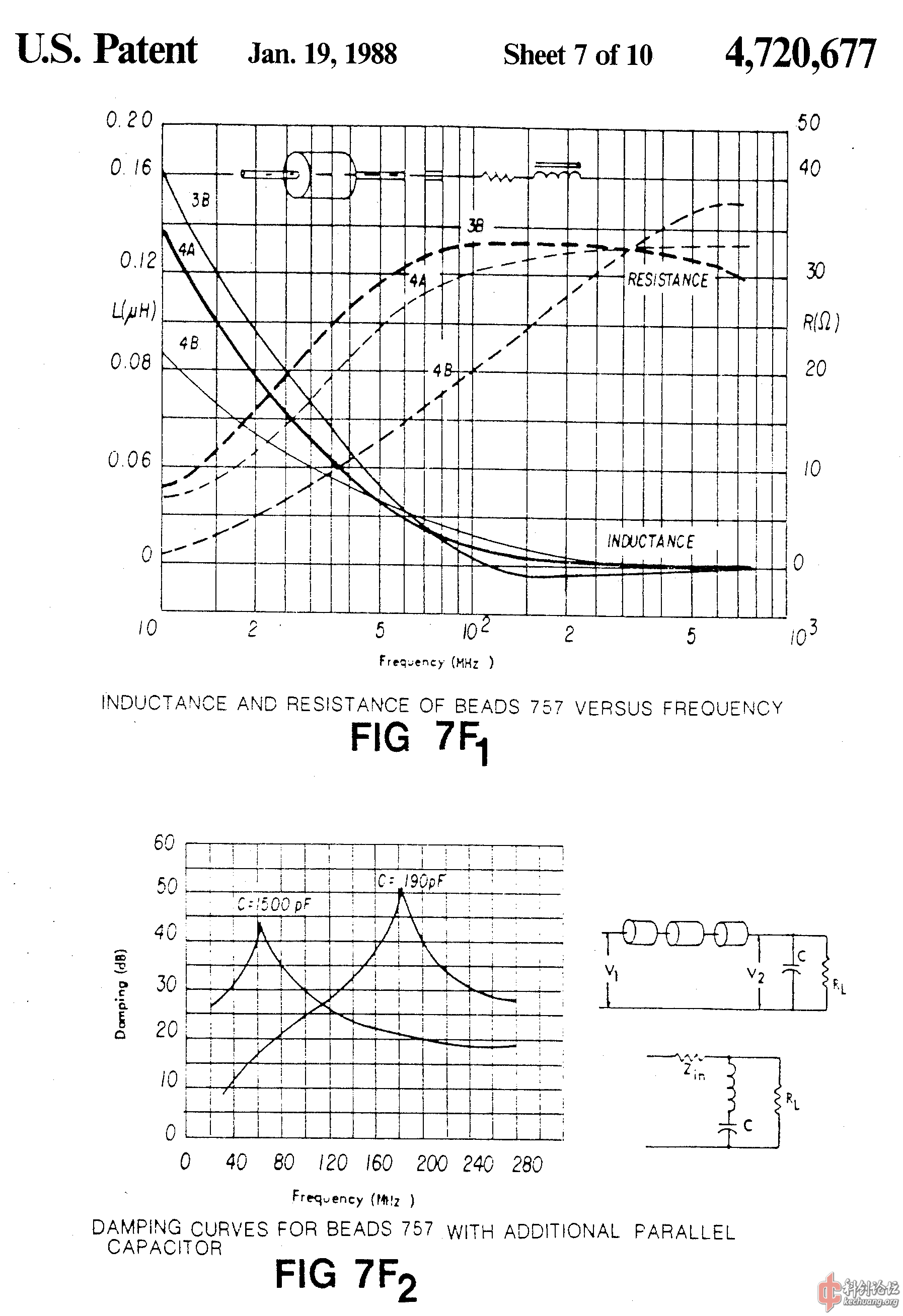

Shown in FIG. 7C is the tail end of the reference load illustrating the single loop of the inner coax threaded through a sequence of nine (9) ferrite shielding beads 757. Such beads are used because they have a high magnetic permeability and are very lossy, so that when the inner coax is eventually shorted to ground, there will be enough series loss to isolate the short and provide a precision reference termination. A typical material for beads 757 is Ferroxcube material 3B (available from Hewlett-Packard Company as stock number 9170-0016), having an initial magnetic permeability of 900 at 20 degrees Celsius. Beads 757 typically have an inner diameter of 0.051 inches, and outer diameter of 0.138 inches, and are 0.159 inches long, so as to achieve an impedance of 300 ohms in this balun section. FIGS. 7F1 and 7F2 are plots of the electrical characteristics of beads 757.

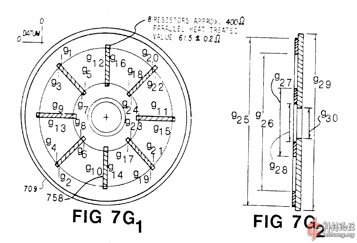

Shown in FIGS. 7G1 and 7G2 is an expanded view of lumped resistor 709 (the equivalent of R02 of FIG. 4). It is generally constructed by connecting inner and outer rings of gold-coated sapphire with eight identical, equally spaced, resistors 758 to obtain a combined resistance of 61.5 ohms.
The outer diameter of the outer ring of the sapphire substrate is typically 0.345 inches and the inner diameter is typically 0.270 inches. The outer diameter of the inner ring is typically 0.135 inches and the inner diameter of the inner ring is typica11y 0.075 inches. Resistors 758 are generally constructed of tantalum. Other typical dimensions shown in FIGS. 7G1 and 7G2 are:

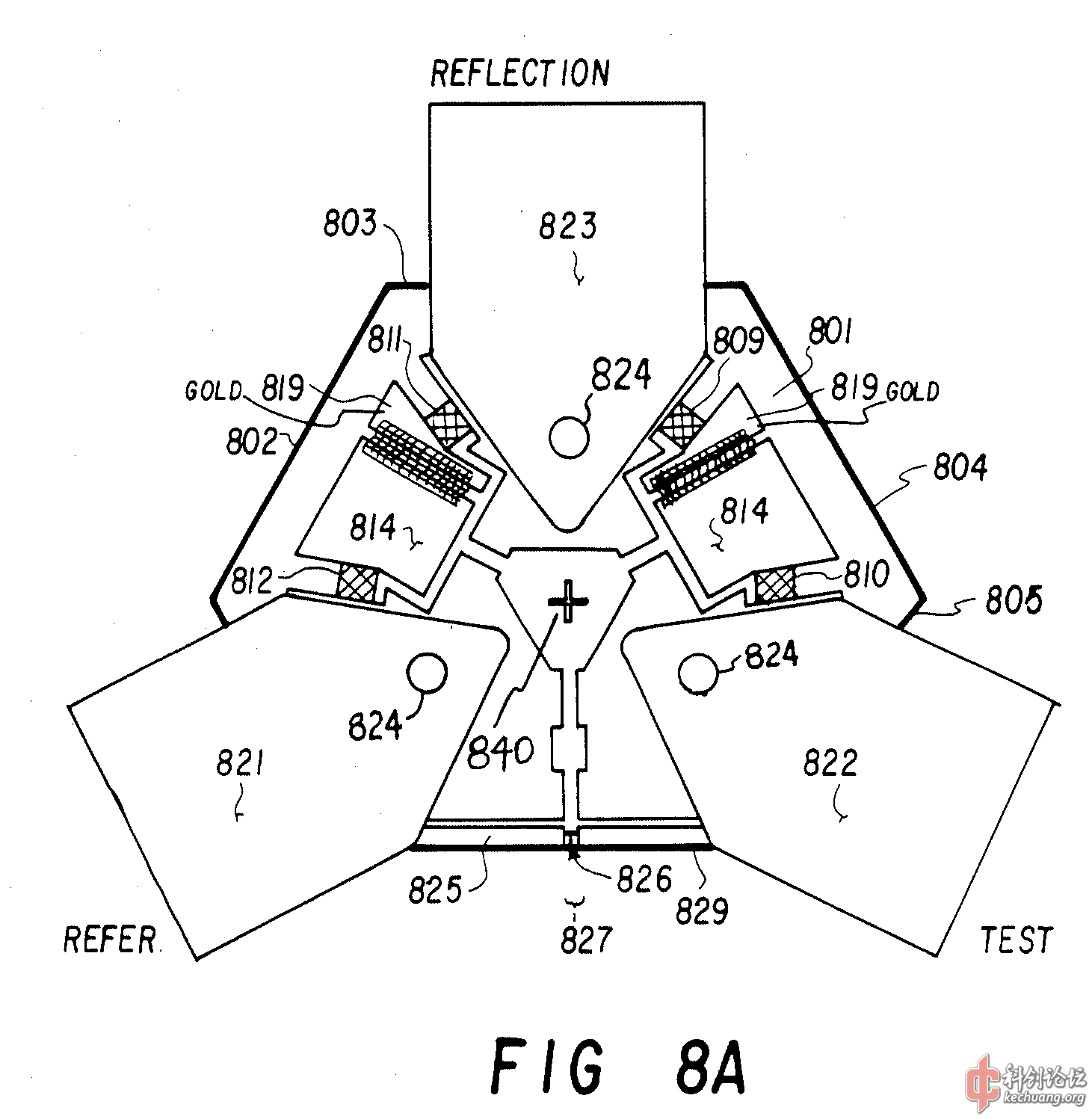

Shown in FIG. 8A is a magnified view of microcircuit 6 which was described briefly in reference to FIG. 6. The microcircuit is formed on a hexagonal sapphire substrate 801 (shown in detail in FIG. 8B) which has a nominal thickness of 10 mils. Geometrically, the circuit has reflection symmetry in a plane passing through the center of the reflection port and the center of the circuit 840. However, the hexagon is not regular. Opposite sides are parallel, sides 802, 803, and 804 are equal in length, and sides 805 and 807 are equal in length. However, side 802 is not the same length as 805 or 806. Table III gives a list of preferred dimensions for the microcircuit. Typically, the gold pattern and tantalum resistors 809, 810, 811, and 812 shown in FIGS. 8A and 8B are put down on both faces of the substrate with resistors on one face being disposed immediately opposite resistors on the other face. The resistance of each resistor 809, 810, 811, and 812 and their counterparts on the opposite face of the substrate is nominally 50.0 ohms, so that the combined resistance in each leg, i.e., between the reflection port and the reference port is 50 ohms and between the reflection port and the test port is 50 ohms. This results from the fact that each leg has a series resistance of 100 ohms on each face, and the two faces provide parallel connections to the ports. The use of two (2) parallel paths per arm helps to pull down the inductance of the system. Four (4) barium titanate single layer dielectric capacitors 814 (two (2) on each face of the substrate with each one opposite an identical one on the opposite face of the substrate) are epoxied in place in series with the resistors and gold wire mesh is used to make electrical contact between gold pads 819 and capacitors 814. Each capacitor is nominally 350 picofarads, and capacitors on opposite faces of the substrate are oriented in opposite direction for symmetry reasons.
Arrowheads 821, 822, and 823 for providing electrical and mechanical connections to each port are typically constructed of beryllium copper turned on a numerically controlled screw machine to a diameter of 0.060 inches. The overall length of the arrowheads is 0.080 inches and includes a cone portion having a length of 0.037 inches to avoid introducing unwanted capacitance into the system. Each cone portion is slotted to a width of about 11 mils to accommodate the 10 mil substrate and is soldered to the substrate via solder holes such as 824. Each arrowhead is gold plated to insure good electrical contact. Also shown in FIG. 8A is inner coax 825 which extends through the reference port arrowhead. Its center conductor 826 bridges a gap 827 of about 0.003 inches and makes contact with a dummy coax 829 typically a conducting rod which electrically connects center conductor 826 directly to the test port. Gap 827 then acts as an R.F. generator midway between the test and reference ports. The diameter of conductor 829, typically 0.013 inches, is the same as the diameter of inner coax 825 in order to maintain electrical and physical symmetry as to both the test port and reference port.
Despite the efforts at maintaining electrical and physical symmetry between ports, it is important to note that such symmetry alone is not sufficient to achieve an adequate port match. This can be most easily seen by noting that looking into the microcircuit from the generator with the test port terminated in 50 ohms, the transmission lines from the generator to the test port and reflection port should be 25 ohms for best termination (since the reflection port looks like a virtual ground because of the symmetry of the device). However, on terminating the reflection port in 50 ohms instead of the test port and looking into the microcircuit from the test port, the desired impedance should look like 100 ohms in each branch, i.e., from the test port to ground through the reflection port,and from the test port to ground through the reference port. To accommodate this poor port match, the microcircuit itself is made very small in order that the parasitic impedances introduced by the microcircuit are small relative to the 50 ohm operating impedance. By deciding on a design criterion for test port return loss, the corresponding maximum desired electrical path length between ports can be calculated using the following relationship:
where L is the electrical path length. By choosing the small interconnecting transmission lines between ports to be approximately 50 ohms and with a design of 20 dB test port return loss, the maximum desired electrical path length in any one of the three arms is found to be 0.10 of the wavelength at the highest frequency. For the geometry described above, this corresponds to 0.045 inches at 26.5 GHz.
Another unique feature of microcircuit 6 is that it is mechanically supported totally by its electrical connections. As illustrated in FIG. 9, which is a cross-section of housing 1, outer coax 901, supports the microcircuit at the reference port. The end most tip of outer coax 901 is typically hemispherical in shape with a hole therethrough to accommodate inner coax 825, and contacts the drilled end 921 of arrowhead 821. The test port of the microcircuit is supported by a spring loaded ball joint 903 which contacts the drilled end 922 of arrowhead 822. The reflection port is supported by a spring loaded piece of slabline 905 which rests in a slot 923 cut in the end of arrowhead 823. This manner of three element mechanical support permits very stable mounting which also permits electrical adjustment within the housing by placing tuning screws (not shown) through bottom ground plane 910 of housing 1 directly under the joint between each arrowhead and its electrical/mechanical connection.

842218
前边的图有个地方标错了。“高频巴伦”和“高频平衡电阻”其实都是些损耗介质。看专利,是些磁损耗材料。“高频巴伦”是高损耗介质。“高频平衡电阻”是低损耗介质。当然,每个元件还做成了阶梯形或渐变锥,实现从右到左损耗逐渐增大。这样外传输线构成了一个高频损耗传输线,这个传输线构成了电桥的一个电阻。即参考电阻R0。
真是服了惠普这帮工程师。

是的,这个是当时没资料的情况下根据经验猜测的。上面的那些多边形磁珠是用来微调平衡的,磁场对介质中的波产生“灵敏的”作用。但是需要注意,那些小的介质并不一定都是吸收用的,不一定一点磁阻作用都没有,否则那个61欧电阻和介质电阻是直接并联关系,要想调平衡在低频段的负载分配就变得非常考究,很难平滑拼接。
需要说明的是,这个桥由于成本太高,已经不生产了,甚至这种结构也很少见到。现在大家又回到了“减少电容,升高干扰阻抗”的老路。这些老的结构,只有历史研究价值,并不能指导现在的设计。
