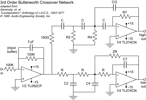

| 计算方法: | ||||||||||
| R的理论值:(频率Fc < 200 Hz时,R = 100 KΩ,否则R = 10 KΩ)
| C = | (10/R)*50
2 π F |
C2 = | 2455.3
2 π F R |
C4 = | 2108.9
2 π F R |
C7 = | 193.1
2 π F R |
| R2 = | 407.4
2 π F C |
R4 = | 474.2
2 π F C |
R7 = | 5176.6
2 π F C |
(C
in (R in |
μF) KΩ) |
