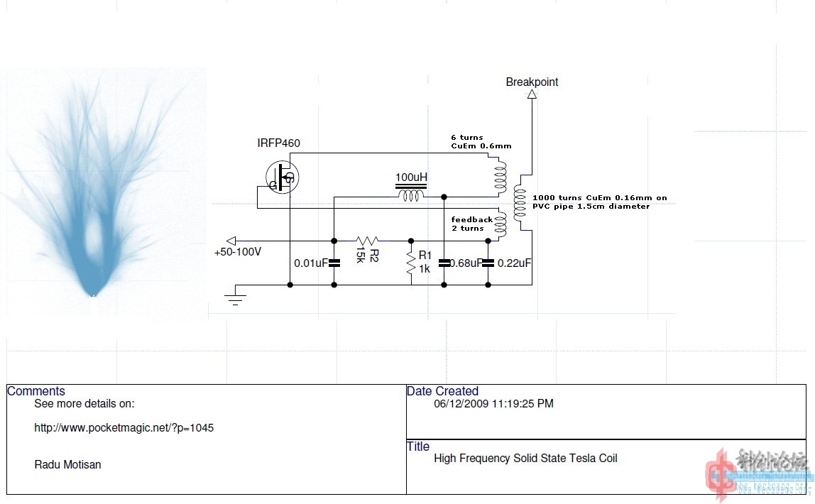

发现一个奇怪的TC图纸  求鉴定
乙醇2011/05/08高电压技术 IP:辽宁
.....不多话  直接上图  看不太懂 ...网上找的一个.  看起来好像很迷你~~

没错的话 应该是这个电路
The tesla transformer, consists of a PVC pipe 1.5cm diameter, with the 1000 turns secondary, inserted inside a larger PVC tube of 2.5cm diameter. The primary and the feedback coils are wound on the larger tube at the bottom. A very compact design that also allows the two tubes to slide, so the primary+feedback goes closer or further from the secondary, allowing to tune the resonance in a very convenient way. Also the mosfet was much cooler now.
以上是对这个电路的描述
分析电路结构 属于用MOS自激振荡的SSTC
本线圈作者对他的描述是High Frequency Solid State Tesla Coil (HF SSTC)
具体工作原理是:
+50~100V电压通过R1 R2电阻 在节点分压 通过feedback线圈
向MOSFET栅极 提供一个50/16~100/16V的电压信号
MOSFET导通 通过限流电感L(100μH)在primary线圈流过电流
通过耦合 向feedback线圈提供一个电信号反馈
使得MOSFET关断 其余电容为控制震荡频率
然后MOSFET导通 进入下个循环
以上是自己的分析
至于电路的改进点
1:在MOSFET栅极加上稳压管 防止导线在高频下产生的高压击穿GS电容
2:可以在MOSFET栅极加上三极管构成的加速电路 来使开关速度加快 减少发热
另外这个电路的资料是 44V输入时 电流为2.18A
以下是作者自己总结的这个HFSSTC的缺点
A few things I've learned:
1) The IRFP460 works best. And it must be a quality manufacturer, else it might not work (I've tested two mosfets with different manufacturer, and the results were not the same)
2) When winding the tesla transformer, keep in mind that sliding the primary over the secondary helps reaching resonance / better performance / cooler mosfet
3) No breakpoint = dead mosfet - be careful!
4) The device produces strong RF interference, so be careful with all the electronics arround, including the digital camera, your computer, etc . Be careful not to touch any metallic object near the HFSSTC, it will burn you.
5) A topload might help, but better run some tests to see how it goes in your case
6) You will need at least 50V to power this oscillator.
Hope this proves useful,
Radu
可见作者对自己线圈的评价还是很中肯的

这个电路,狼的论坛上有位大侠做过了。。效果一般般,电弧有个三四公分

其实这个是VTTC电路的变形。。。
cjboy2008
13年1个月前 IP:未同步
294761
VTTC变体?谐振电容哪儿去了。。
