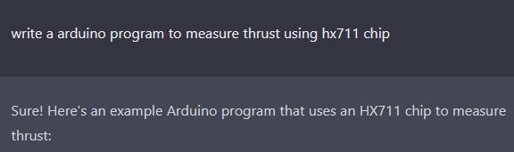

AI编写的推力计程序
warmonkey2023/03/16软件综合 IP:广东
由于你懂的原因,该服务已被厉害国禁用。
本人评价:打败了制造业大国90%的电子工程师
#include "HX711.h"
// Define the pins used for the HX711 chip
const int LOAD_CELL_DATA_PIN = 2;
const int LOAD_CELL_CLOCK_PIN = 3;
// Define the calibration values for the HX711 chip
const float LOAD_CELL_CALIBRATION_FACTOR = 1000.0;  // replace with your calibration factor
// Define the pin used to trigger the measurement
const int TRIGGER_PIN = 4;
// Define the pin used to output the measurement
const int OUTPUT_PIN = 5;
// Create an instance of the HX711 library
HX711 load_cell(LOAD_CELL_DATA_PIN, LOAD_CELL_CLOCK_PIN);
void setup() {
  Serial.begin(9600);
  pinMode(TRIGGER_PIN, INPUT_PULLUP);
  pinMode(OUTPUT_PIN, OUTPUT);
  load_cell.set_scale(LOAD_CELL_CALIBRATION_FACTOR);
  load_cell.tare();
void loop() {
  if (digitalRead(TRIGGER_PIN) == LOW) {
    // Trigger the measurement
    float thrust = load_cell.get_units(10);
    digitalWrite(OUTPUT_PIN, HIGH);
    Serial.println(thrust);
    delay(1000);
    digitalWrite(OUTPUT_PIN, LOW);
In this example, we first define the pins used for the HX711 chip, as well as the calibration factor for the load cell. We also define the pins used to trigger the measurement and output the measurement results. We then create an instance of the HX711 library using the HX711 constructor, passing in the data pin and clock pin for the load cell. In the setup() function, we initialize the serial communication and set the calibration factor and tare value for the load cell. In the loop() function, we wait for the trigger pin to be pulled low, indicating that a measurement should be taken. We then use the get_units() method of the HX711 library to read the thrust measurement, and output the result to the serial port and the output pin. Finally, we delay for a second before resetting the output pin to low and waiting for the next trigger signal.
Note that the specific pins used for the HX711 chip, trigger pin, and output pin may vary depending on your hardware setup. You should consult the datasheets and pinout diagrams for your particular components to determine the correct pins to use. Also, you may need to adjust the calibration factor to match the sensitivity of your load cell.
