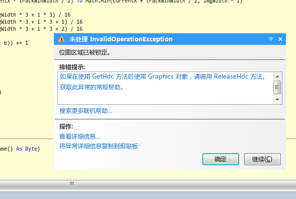

今天特别高兴特别蛋疼,于是把mean shift花了2小时移植到VB上[我知道大部分时间我都在debug]
Mean Shift 算法 在VB.NET上跑,320 x 240,跟踪窗口30 x 30,CPU T6570,内存2G,Win7
实时跟踪绰绰有余
虽然在下一秒……

放出代码
Public Class MeanShift
    Const HISTOGRAM_LENGTH As Integer = 4096
    Private imgWidth As Integer
    Private imgHeight As Integer
    Private trackWinWidth As Integer
    Private trackWinHeight As Integer
    Private currentX As Integer
    Private currentY As Integer
    Private currentHistogram(HISTOGRAM_LENGTH) As Double
    Private tempHistogram(HISTOGRAM_LENGTH) As Double
    Public Sub InitMeanShiftTracker(ByVal firstFrame() As Byte, ByVal frameWidth As Integer, ByVal frameHeight As Integer, _
                ByVal targetPosX As Integer, ByVal targetPosY As Integer, ByVal targetWidth As Integer, ByVal targetHeight As Integer)
        imgWidth = frameWidth
        imgHeight = frameHeight
        currentX = targetPosX
        currentY = targetPosY
        trackWinHeight = targetHeight
        trackWinWidth = targetWidth
    End Sub
    Public Function CalcHistogramSp(ByVal frame() As Byte, ByVal histogram() As Double) As Integer
        Dim pxValue As Integer = 0
        For i As Integer = 0 To HISTOGRAM_LENGTH
            histogram(i) = 0
        Next
        For j As Long = Math.Max(0, currentY - trackWinHeight / 2) To Math.Min(currentY + trackWinHeight / 2, imgHeight - 1)
            For i As Integer = Math.Max(0, currentX - trackWinWidth / 2) To Math.Min(currentX + trackWinWidth / 2, imgWidth - 1)
                Dim r As Integer = frame(j * imgWidth * 3 + i * 3) / 16
                Dim g As Integer = frame(j * imgWidth * 3 + i * 3 + 1) / 16
                Dim b As Integer = frame(j * imgWidth * 3 + i * 3 + 2) / 16
                histogram(Int(256 * r + 16 * g + b)) += 1
                pxValue += 1
            Next
        Next
            histogram(i) /= pxValue
        Next
        Return pxValue
    End Function
    Public Function MeanShiftProcessSp(ByVal frame() As Byte)
        Dim weights(HISTOGRAM_LENGTH) As Double
        Dim newX As Double = 0.0
        Dim newY As Double = 0.0
            If currentHistogram(i) > 0.0 Then
                weights(i) = tempHistogram(i) / currentHistogram(i)
            Else
                weights(i) = 0
            End If
        Next
        Dim sumOfWeights As Double = 0.0
                Dim ptr As Integer = 256 * r + 16 * g + b
                newX += weights(ptr) * i
                newY += weights(ptr) * j
                sumOfWeights += weights(ptr)
            Next
        Next
        If sumOfWeights <> 0 Then
            currentX = Int(newX / sumOfWeights) + 0.5
            currentY = Int(newY / sumOfWeights) + 0.5
        End If
        Return Nothing
    End Function
    Public Function MeanShiftTrackProcess(ByVal frame() As Byte, ByVal frameNumber As Integer)
        If frameNumber = 0 Then
            Me.CalcHistogramSp(frame, tempHistogram)
        Else
            Dim stopThreshold As Integer = 10
            Dim counter As Integer = 0
            While counter < stopThreshold
                Me.CalcHistogramSp(frame, currentHistogram)
                Me.MeanShiftProcessSp(frame)
                counter += 1
            End While
            Me.DrawTrackBox(frame)
        End If
        Return Nothing
    End Function
    Public Sub DrawTrackBox(ByVal frame() As Byte)
        For i As Integer = currentX To Math.Min(imgWidth, currentX + trackWinWidth)
            frame(currentY * imgWidth * 3 + i * 3 + 0) = 0
            frame(currentY * imgWidth * 3 + i * 3 + 1) = 0
            frame(currentY * imgWidth * 3 + i * 3 + 2) = 255
            frame(Math.Min(imgHeight - 1, currentY + trackWinHeight) * imgWidth * 3 + i * 3 + 0) = 0
            frame(Math.Min(imgHeight - 1, currentY + trackWinHeight) * imgWidth * 3 + i * 3 + 1) = 0
            frame(Math.Min(imgHeight - 1, currentY + trackWinHeight) * imgWidth * 3 + i * 3 + 2) = 255
        Next
        For j As Integer = currentY To Math.Min(imgHeight - 1, currentY + trackWinHeight)
            frame(j * imgWidth * 3 + currentX * 3 + 0) = 0
            frame(j * imgWidth * 3 + currentX * 3 + 1) = 0
            frame(j * imgWidth * 3 + currentX * 3 + 2) = 255
            frame(j * imgWidth * 3 + Math.Min(imgWidth - 1, currentX + trackWinWidth) * 3 + 0) = 0
            frame(j * imgWidth * 3 + Math.Min(imgWidth - 1, currentX + trackWinWidth) * 3 + 1) = 0
            frame(j * imgWidth * 3 + Math.Min(imgWidth - 1, currentX + trackWinWidth) * 3 + 2) = 255
        Next
    End Sub
End Class
