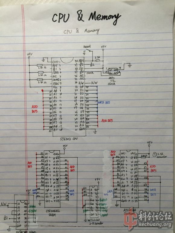

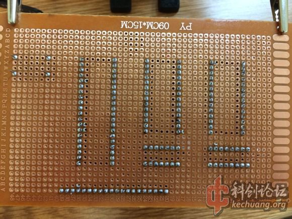

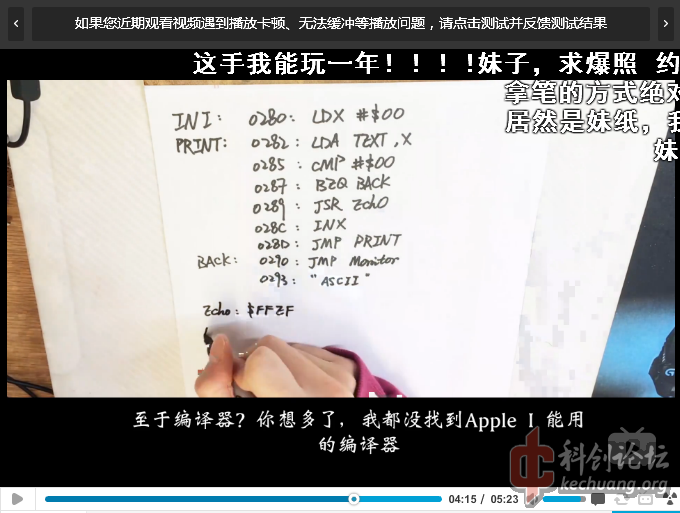

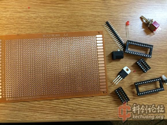

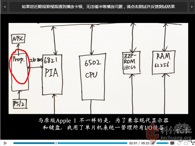

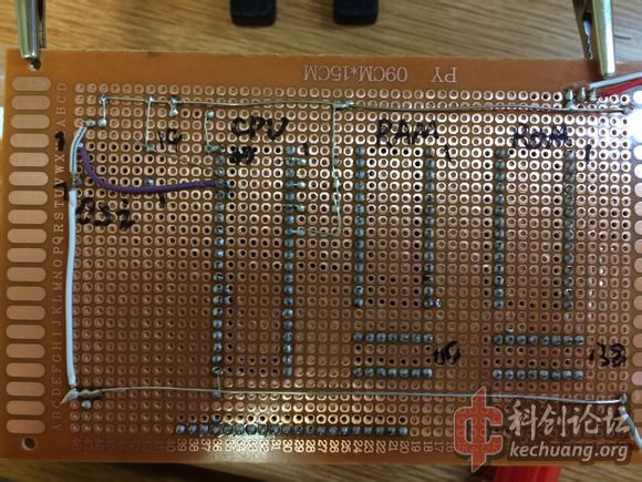

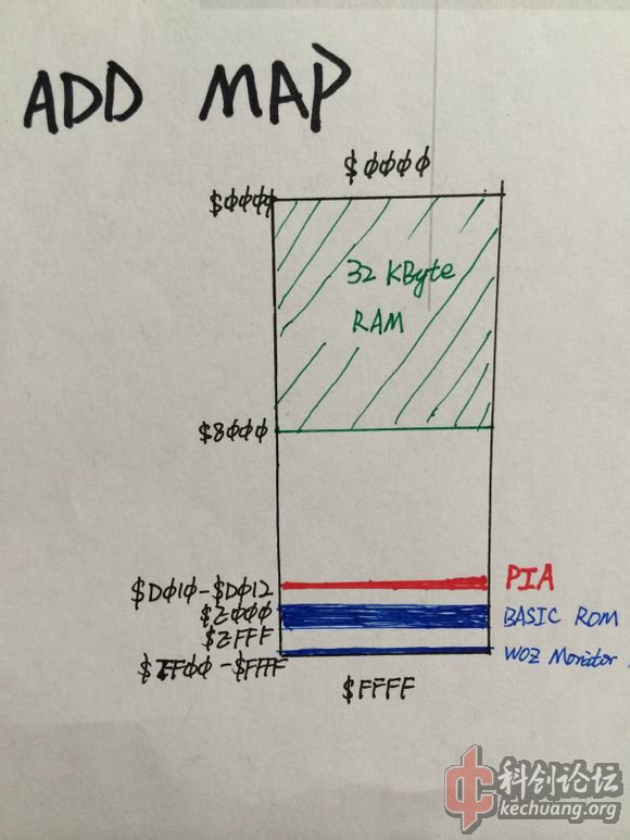

教你组装Apple I (1976) [转]
神之觉醒2015/03/08计算机电子学 IP:广西
组装视频, 绝对震撼!!!
XXXXXXXXXXXXXXXXXXXXXXX/video/av2062604/
XXXXXXXXXXXXXXXXXXXXXX/p/3610219730
想帮TA弄个编译器~
把内存值读出来刷屏!!!
b29010dfa9ec8a13a92515ebf303918fa0ecc03f.jpg 2a401f178a82b901face9c38778da9773812ef93.jpg

6502有个c编译器的,不过效率很低,编译出的ROM很大,不如ASM的编译器
