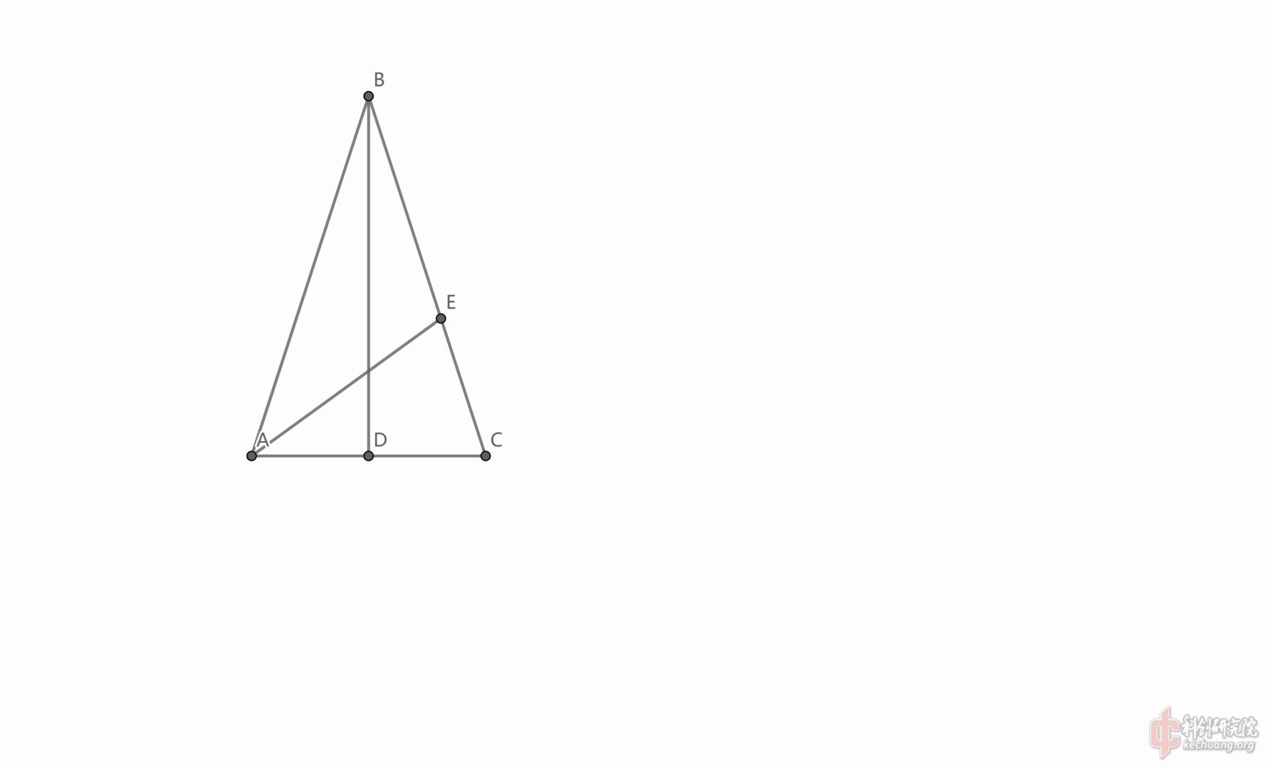

一 构造黄金三角形(底角为72°的等腰三角形)
这一步主要的目的是求18°的三角函数值,先构造一个黄金三角形$\Delta ABC$(如图)
在$\Delta ABC$ 中,
过点作$\angle BAC$的角平分线交边BC于点E。过点B作边AC的垂直平分线交边AC于点D。
$$\begin{array}{l} \because \angle B A C=\angle B C A=72^{\circ} \\ \therefore \triangle A B C=180^{\circ}-2 \angle B A C=36^{\circ}\\ \therefore \angle C A E=\frac{1}{2} \angle B A C=36^{\circ} \\ \Rightarrow \angle A E C=180^{\circ}-\angle C A E-\angle A C E=72^{\circ} \\ \because \angle A E C=\angle A C E=72^{\circ} \\ \therefore A C=A E \\ \angle A E B=180^{\circ}-\angle A E C=108^{\circ} \\ \therefore \angle B A E=\frac{1}{2} \angle B A C=36^{\circ} \\ \therefore A E=B E \\ \text { 令} A B=C B=1, A D=C D =x \\ \because \angle A B C=\angle C A E=36^{\circ} \\ \angle B A C=\angle A C E=\angle B C A=\angle A E C=72^{\circ} \\ \therefore \triangle A B C \sim \triangle C A E(SSS)\text{即有,} \frac{A B}{A C}=\frac{A C}{C E} \\ \because C E=B C-B E=1-2 x \\ A C=2 A D=2x\\ \text{有,} \\ \frac{1}{2 x}=\frac{2x}{1-2x}\\ \text{得:}x=\frac{-\sqrt{5}-1}{4} \text{(舍去);} x=\frac{\sqrt{5}-1}{4}\\ \because B D 垂直平分 A C \\ 又\because \triangle ABD =\frac{1}{2} \angle ABC=18^{\circ}\\ 在Rt\triangle ABD 中,BD=\sqrt{AB^2-AD^2}=\frac{\sqrt{2}}{4} \sqrt{5+\sqrt{5}} \\ \text { 故, }\\\sin 18^{\circ}=\frac{A D}{A B}=\frac{\sqrt{5}-1}{4} \\ \cos 18^{\circ}=\frac{B D}{A B}=\frac{\sqrt{2}}{4} \sqrt{5+\sqrt{5}} \\ \tan 18^{\circ}=\frac{A B}{B D}=\frac{3\sqrt{10}-5\sqrt{2} }{20}\sqrt{5+\sqrt{5}}\\ \Box \end{array}$$
