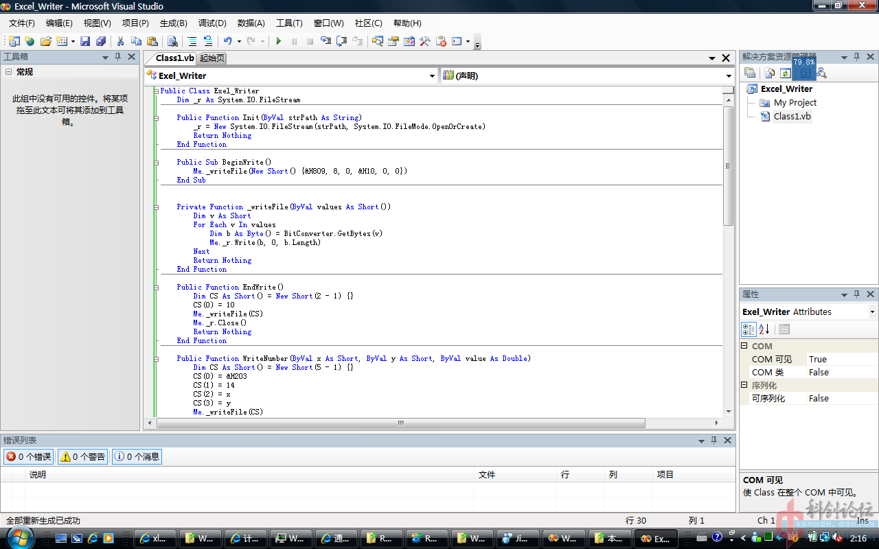

这个是给某人做项目的时候写的。
原本是C#的,我改写成VB.NET了,并且编译了一个dll。
attachment icon Excel_Writer.rar 4.40KB RAR 58次下载 <<<<<<<<---
测试通过,很好用
原文地址http://blog.csdn.net/jinjazz/archive/2008/08/01/2753869.aspx

下面是代码
Public Class Exel_Writer
    Dim _r As System.IO.FileStream
    Public Function Init(ByVal strPath As String)
        _r = New System.IO.FileStream(strPath, System.IO.FileMode.OpenOrCreate)
        Return Nothing
    End Function
    Public Sub BeginWrite()
        Me._writeFile(New Short() {&H809, 8, 0, &H10, 0, 0})
    End Sub
    Private Function _writeFile(ByVal values As Short())
        Dim v As Short
        For Each v In values
            Dim b As Byte() = BitConverter.GetBytes(v)
            Me._r.Write(b, 0, b.Length)
        Next
        Return Nothing
    End Function
    Public Function EndWrite()
        Dim CS As Short() = New Short(2 - 1) {}
        CS(0) = 10
        Me._writeFile(CS)
        Me._r.Close()
        Return Nothing
    End Function
    Public Function WriteNumber(ByVal x As Short, ByVal y As Short, ByVal value As Double)
        Dim CS As Short() = New Short(5 - 1) {}
        CS(0) = &H203
        CS(1) = 14
        CS(2) = x
        CS(3) = y
        Me._writeFile(CS)
        Dim b As Byte() = BitConverter.GetBytes(value)
        Return Nothing
    End Function
    Public Function WriteString(ByVal x As Short, ByVal y As Short, ByVal value As String)
        Dim b As Byte() = System.Text.Encoding.Default.GetBytes(value)
        Dim CS As Short() = New Short(6 - 1) {}
        CS(0) = &H204
        CS(1) = CShort((b.Length + 8))
        CS(2) = x
        CS(3) = y
        CS(5) = CShort(b.Length)
        Me._writeFile(CS)
        Return Nothing
    End Function
End Class
