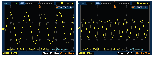

    1) The realization of heterodyne-beat method
    The kernel of heterodyne-beat method is the shift of spectrum. As a result, a mixer is used to obtain the difference in frequency of two
signals. In this application, two integrated mixer circuits AD831 were used.

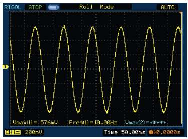

    The following images indicate a test result for the mixer circuit. The left image indicates the signal of RF input of the mixer and another
one shows the local oscillation input of the mixer. They were generated by two DDS(Direct Digital Synthesis) circuits. The clock standard of the DDS
circuits was connected to an AFS. The frequencies of them were 7MHz and 7.00001MHz.
    The following image shows the output of the mixer which equals to the difference between two frequency signals connected to the local
oscillation input and the RF input. Here, the difference was 10Hz.

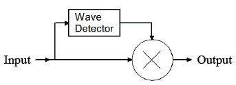

    2) The design of AGC circuit
    An AGC circuit was used to stabilize the amplitude of IF signal.
    The input signal was demodulated and filtered into a voltage signal represents the strength of the signal. This voltage signal was used to
control the gain of a VGA(Variable Gain Amplifier).
    In this case, the wave-detector was AD8307 and the VGA was AD603.
    A test for the AGC module is shown below. Channel 1 was connected to the output of the AGC module, channel 2 was connected to the
input. The input of the AGC module was connected to a function generator.
    As the waveform shown on the oscilloscope, although the amplitude of the input signal to the AGC was changed, the amplitude of output
signal of it remained the same.

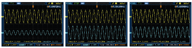

    A test result for the transmitter and the receiver is shown below.
    The transmitter was placed 800 metres away from the receiver. The image on the left shows the output signal from the transmitter and
another image shows the signal sampled from the output of LNA of the receiver.
    The image below shows the signal sampled from the output of the AGC module, where frequency = IF = 5MHz.

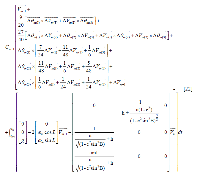

2) Data processing
  a) Downlink signal
    The navigation system provided data of dynamics with a sample rate of 1,200 samples per second. The data was given in terms of
angular velocity and acceleration in the on-board coordinate. The six groups of parameters are ωx, ωy, ωz, ax, ay and a--z, respectively where the
X-axis if the mean axis of the rocket.
    In the determination of change in angle, △θ and change in velocity, △V, the cubic spline function is adopted in curve fitting before
integration. This method of Simpson's rule provides six groups of data: △θx, △θy, △θz, △Vx, △Vy and △Vz. As a result, the behaviour of the rocket
between samples are predicted and considered.
    In the determination of attitude angle, the method of Quaternion is applied.

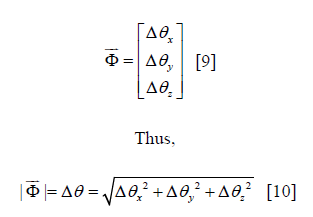

    The quaternion numbers at time tm+1 are given in equation [9], where △θx, △θy and △θz are the output of change in angle and vector Φ
is the rotation vector, which is given by equation [9]
    In equation [9] and [10], the angular velocity of the rocket is assumed to fit cubic function. However,  the actual angular velocity does not
fit a cubic function.
    Equations [9] and [10] do not achieve minimum shift of algorithm. After the parachute deployment, the rocket was suspended in the
descending stage. Thus the rocket is likely to experience coning motion, which means that the rocket vibrate about the equilibrium position at
small angles. The coning motion is the worst working environment for the SINS(Strapdown Inertial Navigation System) as it will cause serve shift of
the Math Platform.
For optimization algorithms, the following improvements are made.
    O-XYZ represents the reference frame R, which is the on-board frame when the rocket is in equilibrium.
    Let b(tm-1) and b(tm) to be the instantaneous on-board frame at time tm-1 and tm.
    According to Euler Theorem, O-XYZ can be regarded as a rotating transformation of b(tm) or b(tm-1) with rotating vector Q(t) given in
equation [11].
    The shift on-board frame can be regarded as a rotation transformation of the ideal on-board frame, which is the frame when the rocket
is in equilibrium. The samples of △θ is grouped in three again.
    In each group, the samples are labeled as .
    Equation [12] is an improved  form of equation [3]. By selecting proper constant k1 and k2, the effect of the coning motion is minimised.
Here, the ideal values for k1 and k2 are 0.45 and 0.675.
    Therefore, the attitude of the rocket is found through the optimized quaternion algorithm. The Eular angles are found by equation [13].
    The quaternions are supposed to be standardized. However, resulting form calculation errors and other factors, the quaternion numbers
gradually loses standability. The standardization of quaternion numbers is applied at the end of each period of attitude refreshment. The formula
for standardization is given by equation [8].
    Where  is the standardization value and  is the value after attitude refreshment.
    So far, the discussion of the rocket's dynamic is in the on-board coordinate. However, the final results have to be expressed in the
navigation frame, which sets the ground base as the origin.
Equation [15] gives the coordinate transformation matrix (attitude matrix) from on-board frame to navigation frame in terms of quaternion.
    The initial extraction quaternion numbers are thus given by the initial attitude matrix obtained in initial azimuth alignment.

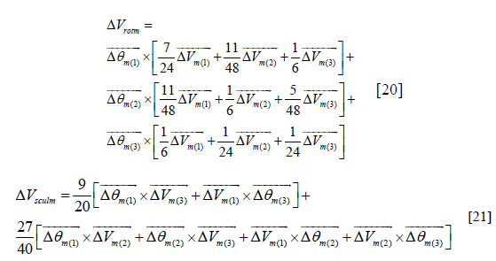

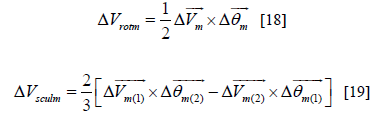

    The velocity of the rocket at time tm in the navigation frame, Vm, is given by equation [16], containing a series of error compensations.
Vm-1 is the velocity in the same frame at time
tm-1. Cm-1 is the coordinate transformation matrix at time tm-1. Vm-1 is the compensation velocity caused by while△Vg/corm is the
compensation velocity caused by the deleterious acceleration. △Vsfm is the compensation velocity caused by ecific force.

The final expression for Vm is given by equation [22]:
    Considering that all the compensation dosages have been taken into account the calculation of Vm and that the data is discrete with
equal time internals, the data of displacement, is obtained through numerical integration.
    As the dynamic data is determined, the following equations are substituted into
    equation [2].

caused by the angular vibration and linear vibration are in phase and of same frequency on the rocket. This is quite similar to the sculling motion:
on one hand, the syrup vibrates periodically about the lateral axis of the boat. On the other hand, the boat forges ahead along the direct-axis in
an intermittent behaviour.
    The original expression for △Vrotm and △Vsculm are:
    The optimized formula for △Vrotm and △Vsculm are
    The optimized algorithm for sculling effect rotation effect, in velocity determination as well as the correction for conning motion in
attitude determination make sure that the motion of the layload is precisely calculated in spite of the unstable motion of the rocket. Hence the
cancelling of doppler effect and second-order general relativity conception shift are more reliable. The specific precision level is related in the
discussion section.

    1)实现差拍法
    差拍方法的核心是频谱的转变。因此,混频器是用来获取在两个不同的频率
信号。在此应用中,两个集成混频器电路AD831。
    下面的图像显示了混频器电路的测试结果。左边的图像显示的混频器的RF输入和其他信号
一个显示混频器的本振输入。他们所产生的两个DDS(直接数字合成)电路。 DDS的时钟标准
电路连接到一个AFS。他们的频率分别为7MHz和7.00001MHz。
    下面的图像显示混频器的输出等于两个频率信号连接到本地之间的差异
振荡输入和RF输入。在这里,不同的是为10Hz。

取消多普勒效应和二阶广义相对论的概念转变,更可靠。在具体的精度水平相关
讨论部分。
为VM的最后一个表达式是由公式[22]:
    鉴于已考虑到所有的补偿剂量的VM的计算和数据是离散的
相等的时间内部,流离失所的数据,通过数值积分获得。
    由于动态的数据是确定的,下面的公式代入
